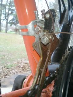

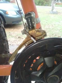

Hello,
New here.
I'm trying to clean up a neglected bike and need to replace the front derailleur. It's a cheap bike and will just be ridden occasionally on pavement and rarely will change gears but I would still like it to function as intended.
There are 3 sprockets in the front and a derailleur with the name falcon on it.
Where is the recommended place to get a replacement? If the price difference is not very much, is there something better to replace it with?
Here are some pics:

It is a Falcon - a company that make many low end bike parts.
Looks like top pull; this one will work well:
http://www.amazon.com/Clamp--31-8mm-Pull-Front-Derailleur/dp/B005V4R684/

You do need one for 3 chainrings, but it looks like either would be fine.
Note that you should measure the diameter of the tube that the derailleur clamps on to on your bike and make sure it is the same size as the "clamp diameter" of the new derailleur.
