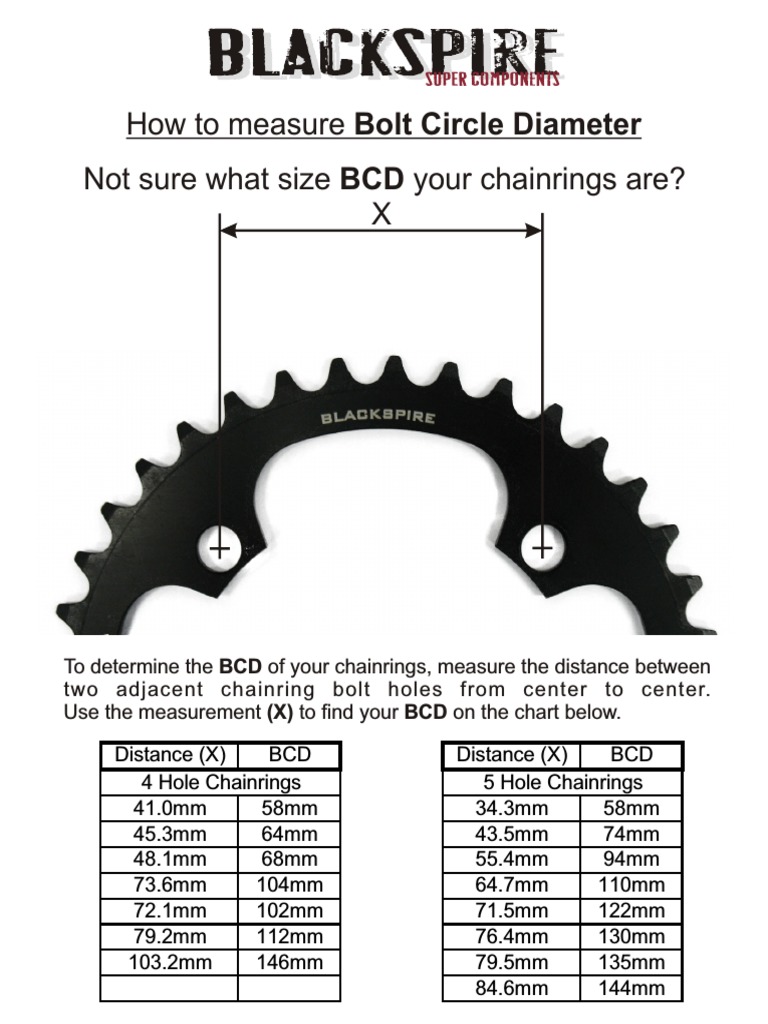

Converting 07 rockhopper to 1x
#1
I have a specialized rockhopper 07 with an absolutely massive front chain ring that catches on the many logs that cross the trail I ride on. I almost never take it out of the middle gear, I change gears in the back. What would I need to convert the front crankset to 1x ?
  Reply
#2
Depends on the crankset. If the middle ring is the same Bolt Circle Diameter as the large ring, then all you need is a pair of singlet chainring bolts. You can take the crank to your local bike shop and maybe they have everything and can do everything for you.
Otherwise, you'll need a chainring bolt wrench and likely a hex to remove the bolts, remove the large ring, replace it with the middle ring, and then fasten it with the new single bolts you can order online.
If the middle ring is a different bolt circle diameter, you simply need only to remove the front ring. Maybe replace it with a bashguard.
  Reply
#3
thank you for the detailed reply. Is their a special way you have to measure the bolt circle diameter?
  Reply
#4
You can follow this chart. But you will know if they are the same BCD if they are joined together through the same hole.
[Image: 1625551977?v=1]
  Reply
Possibly Related Threads...
Forum Jump:
10 Latest Posts
Yesterday 11:08 AM
Are 26" really dying out?
Yesterday 11:02 AM
Yesterday 04:03 AM
Hatch Chiles Rule!
11-09-2026 04:56 PM
11-09-2026 05:21 AM
How Bad Are E-bikes By You?
11-08-2026 10:29 PM
Shortness of breath.
11-08-2026 09:56 PM
Hello All
11-06-2026 09:03 AM
11-06-2026 02:48 AM
11-06-2026 02:44 AM
Join BikeRide on Strava
Top 5 Posters This Month
no avatar 1. Flowrider
21 posts
no avatar 2. ReapThaWhirlwind
11 posts
no avatar 3. meamoantonio
11 posts
no avatar 4. GirishH
9 posts
no avatar 5. Clark
6 posts
