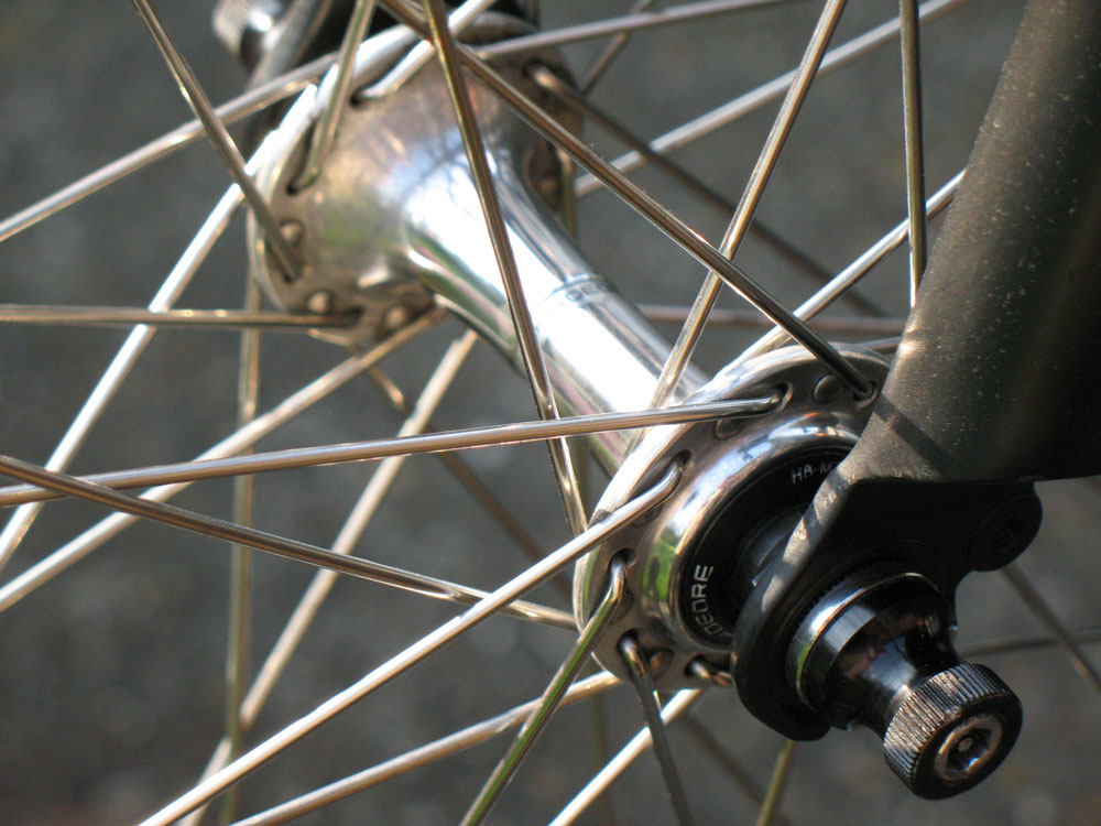

Yes, I'd go along with that. I'd go for stainless, and a good brand:
DT Swiss Champion 14g plain guage and/or DT Swiss Competion 14/16 guage double butted.
Sapim Leader 14g plain guage and/or Sapim Race 14/16 guage double butted.
Wheelsmith SS14 14g plain guage and/or Wheelsmith DB14 or XL14 double butted.
I don't think there's much to choose between the quality of these three brands, so I'd go for whichever you can get for the best price.
I'd probably copy SPA Cyles: http://www.spacycles.co.uk/products.php?plid=m2b0s200p0, they have a good reputation for handbuilt wheels, and use double butted, except for the drive side of the rear wheel, where I'd use plain guage.
The great thing about quality stainless spokes, apart from being really stong, is that they look good for years. I don't know what brand they are, but these stainless spokes are 22 years old:
[Image: UK07.jpg]
Also, when you buy new Shimano hubs, with cups and cones, they come factory adjusted, but the adjustment is never usually that good. I'd re-adjust them before I first used them, remembering to take into account tightening effect the quick release skewer has on the bearings when you fit them to the bike. This way your bearings will probably roll better and last longer than they will if you leave them factory adjusted.
http://sheldonbrown.com/cone-adjustment.html
