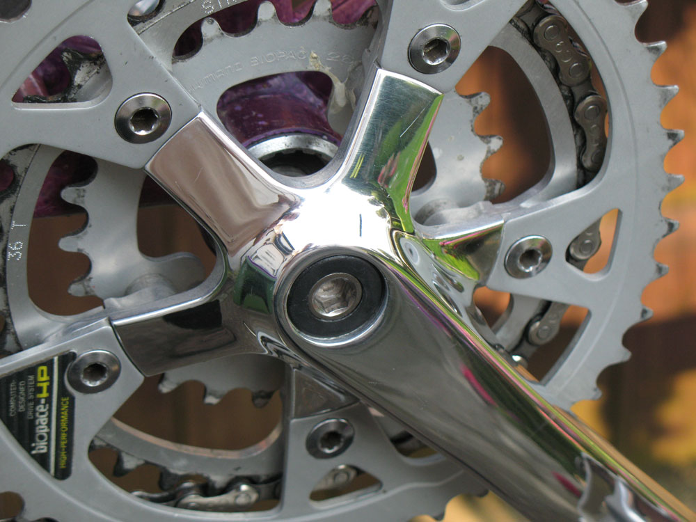

I polished the cranks on my MTB:
[Image: UK05.jpg]
These were originally a sort of matt/satin finish, but had become quite scruffy over the years. I first used some 1200 grit wet and dry to smooth them all over and then used Brasso and a soft cloth (old T-shirt) to polish them and buff them up to a shine.
It took me an hour or so to do both cranks and you can see that it's not a perfect mirror finish and that there are still a few scratches left. If I spent a little longer and perhaps started with a coarser grade wet and dry before the 1200 grit and then the final polish I could get those scratches out, but I was happy with how they turned out and it's a big improvement on how they started.
