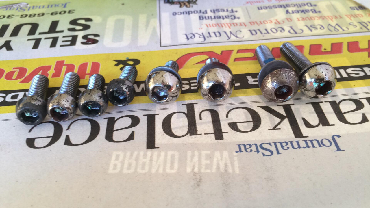

I just wanted to show how I rescue rusty bits and pieces using Evapo-rust. does a decent job for just soaking, letting it work, then rinse and lightly scrub and then off to the bench polisher. this is how to start off and I will post pics of the finished bolts when complete. I think you will be pleasantly surprised at the results. [Image: vaporst1.jpg]

This is what to expect after 24 hrs. soaking in the vapo-rust solution, dried and wiped off. The next step is off to the bench polishing using the red rouge bar. It is important to understand that steel nuts and bolts that have been chromed and let to rust over a period of time are just that, "rusted". The chrome is normally forgone to better days. The key here is to save them and to make them more presentable than just old rusty bolts. The key is to take measures from the start to slow this from happening in the first place. I will discuss the a bit later. However when picking up a used bicycle to refurb and flip, this condition is all to common. But this type of resto to the small bits and pieces is critical for the finished bike to "Pop" and look as if it is in a more pristine state and to aid in the eventual sale of the finished product.

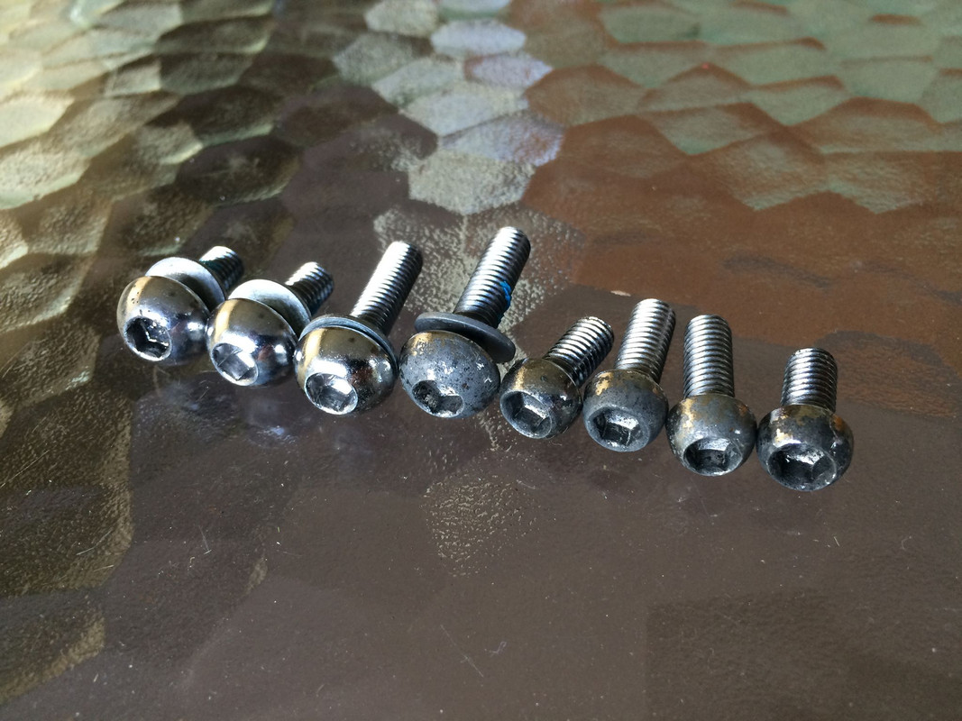

The results are in. Did the vapo-rust take the rust off? Yes it did. Do the bolts look better than all rusted? Probably, but if they were so rusted that the chrome is gone, It is time to replace it if you want the little details to be as perfect as possible. Most of time on a top notch refurb, the result I shoot for is 95% plus perfect. The bolts in the picture fail this standard of mine across the board. however on this bike I will use them since this is a bicycle I paid $10 for and cost for new bolts can add up quite fast and hurt the bottom line. Which I am giving the bike away to someone who just needs a bicycle to ride around the hood with the kids.

So in the end the key is to not let your chrome get in this condition in the first place. So whether you are storing your bike or not, Keep wax or even a thin layer of oil on them. Just use an oil soaked ear q-tip soaked in lube and rub on your bolt heads and in the hex hole and they will remain nicer for a much longer time.
