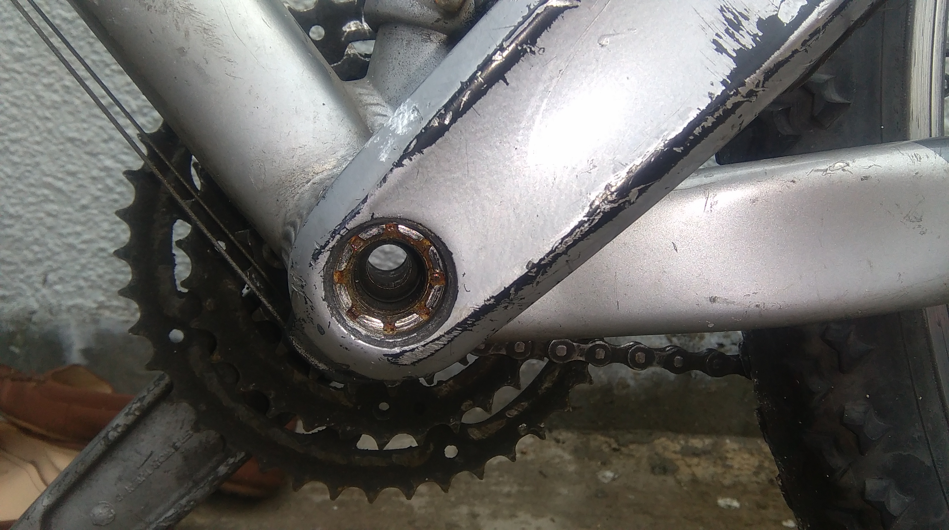

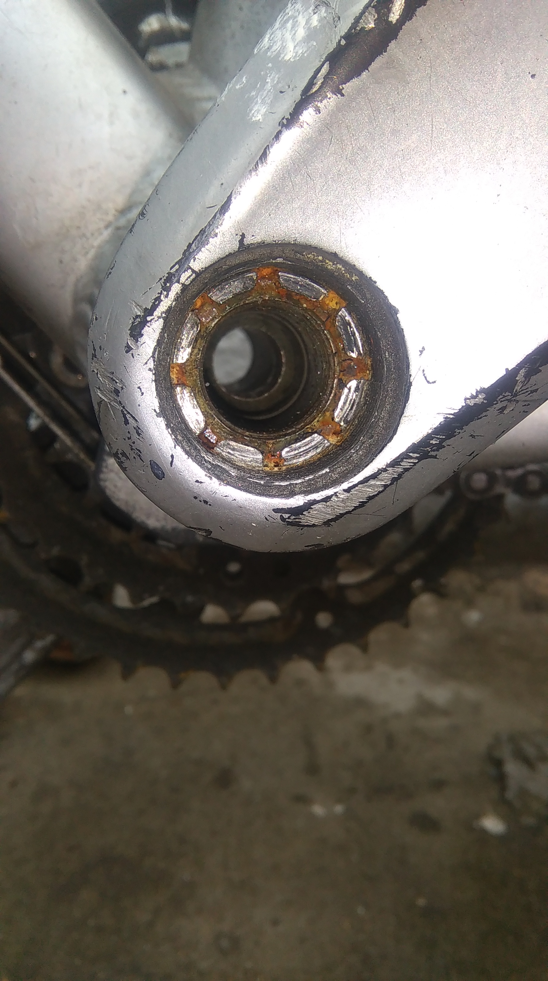

#3
Thank you for reply painkiller but I'm still lost. I'm sending the pictures http://www.photo-host.org/images/2015/09/16/Y6Ta9.jpg http://www.photo-host.org/images/2015/09/16/RtYIZAmiP.jpg
It might be isis as you say however I'm not sure. Any idea?

#4
looks like a octalink v1 or v2 . 8 spline. The park puller should work. standard cartridge bb removal tool if removing that. Take a look at this link to tell between the v1 and v2. you will know once the crank is off. your crank looks like it could seized on.
second reason not to buy a puller with a lever built in.
http://www.sheldonbrown.com/bbsize.html#shimano
you must have an older style puller. There is only a fraction of an inch of meat that the new puller utilizes to get the push pull you need. I would squirt some solvent on yours and let soak a bit before attempting to remove. Make sure to use some grease on things before reassembly. you must have removed the crank bolt already. they differ from a square taper bolt as the threaded part is much fatter and does not really look like a bolt

#5
Your information is very helpful. It seems like I have crank puller for square taper which is not suitable for octalink. As you say I need park tool for octalink bottom backet. I also made mistake buying square taper crankset without knowing which type of my bottom bracket is. Now I need new tool, new parts and some grease to make it happen.
