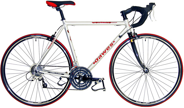

This one?<br />
http://www.bikesdirect.com/products/dawes/images/lt1200_07_600.jpg
Ah, OK, I didn't know that you already have a (probably?) shot freehub. Then: Yes, replace the wheel. The wheelset you posted might be OK, if you are on a budget, I cannot comment on the quality of the build. The components are simple, the hubs entry level. If the wheels are well laced and you maintain the hubs well, they should last you a while. Looking at the description at BD, I'd say they should be an improvement.
