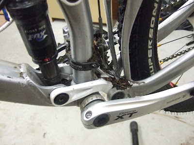

hey guys, sorry to intervene in this thread, but I in fact just joined to make a post about this, but I see there is already one, Im having the same problem but how would I tighten the bolt, there is not enough leeway for the spanner inside the center, would I have to take the cogs off ? Thanks Smile

Of the three pictured with one do you have?

(04-23-2011, 01:08 PM)Bill Wrote:  Of the three pictured with one do you have?
Hey again, sorry for the delay, but I have taken some pictures of my own crank as I wasn't sure if they might be different.. How would I tighten this?
Here are the pictures...
http://i580.photobucket.com/albums/ss247/cogman12345/DSC00575-1.jpg
http://i580.photobucket.com/albums/ss247/cogman12345/DSC00574.jpg
http://i580.photobucket.com/albums/ss247/cogman12345/DSC00573.jpg
Hi and welcome,
I have the same crank as yourself, I use a 14mm socket set to remove the bolt and washer, then a crank puller is required to get the crank off. Be careful with the crank puller as they can strip the threads if not seated properly, as I have found out to my cost, this week.
  Reply
Hi and welcome,
Does this mean I have to replace it?
  Reply
